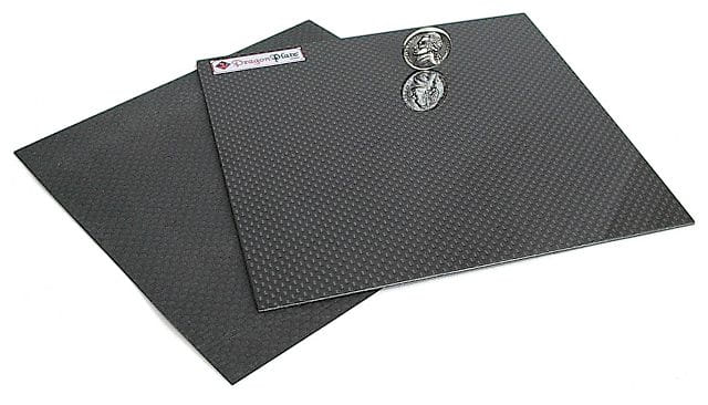

I’m using my current coping sled:
But the ¾” MDF I used as the base is too fricken high. In order to make the cut I need with my slot cutter the shaft of the bit is only about ½” in the collet. I know this is not the best thing for safety or accuracy. I can see that the cuts don’t come out as precise when the bit is used this way. So I’d like to make another version of this sled with a ¼” thick base. But with the strong force of the toggle clamps I need the material to be as stiff as possible. My 1st thought is this carbon fiber laminate I used to use on model airplanes:
http://www.dragonplate.com/ecart/categories.asp?cID=3
It’s incredibly stiff and incredibly expensive!
Any other ideas would be appreciated as I don’t think standard ¼” ply is going to cut it!
THANKS!
