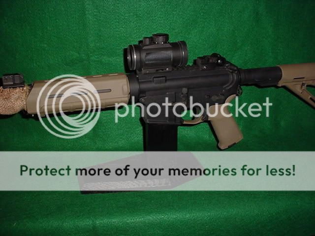

A 45 degree router bit makes a nice 45 degree edge.
I did this one with a bit with a bearing and router table.
