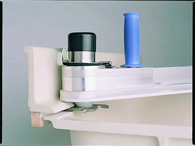

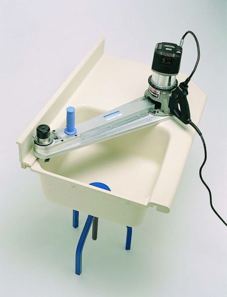

The "standard" method I've used a couple of times for sink removal in-situ (i.e. where it is not possible to remove the worktop/counter) is a specialist sink removing tool, based on the router like the Pinske Edge tool which allows in-situ removal of sinks even when the worktop/countertop has an upstand (very common). They are a lot like a giant version of the offset base available for laminate trimmers
Over here we can hire these by the day or week - good job, too at that price! In the USA there are several firms who hire them out as well, including Pinske. The cutters are available separately but at $229 a pop they aren't cheap either. If you are dealing with a top without obstructions such as upstands in the way (e.g. in an island unit) there is a cheaper wing bowl cut-out bit available (for anyone in the EU Wealden Tool do a sink bowl slitter for a very reasonable £53.70 - Titman and Trend also sell similar items)
The dimension "E" above is 27mm, or 1-1/16in.
In both cases you'll need to support the sink to stop it breaking away from the top and leaving you with a real headache of repair work - the blue "spider" in the first photo is a sink support designed for the purpose.
