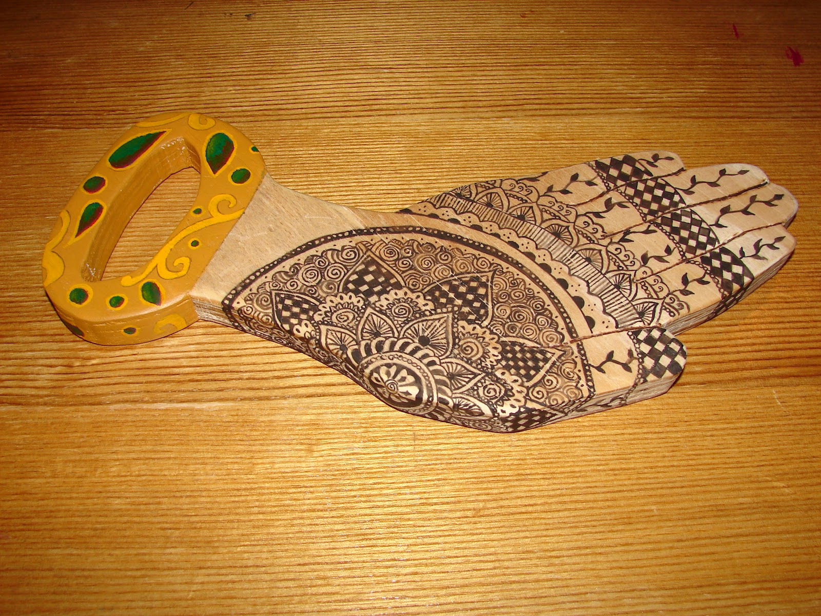

post #3 of 107 (permalink) Old 12-04-2015, 01:48 AM
sunnybob's Avatar
Join Date: Apr 2015
Country: Cyprus
First Name: Bob
Posts: 1,921
picture 1.
KISS (Keep It Simple, Stupid) because its heartbreaking to put all that work into something thats gonna get chewed up on a regular basis.
9mm ply, make a template, cut a half dozen at a time. Sorted.
