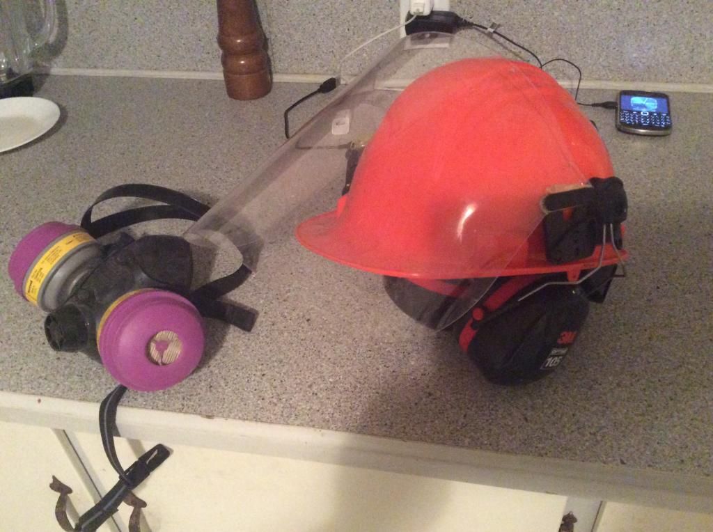

Your a smart man as dust is no joke . I bought a mask that has paper pre filters before it goes to the filtration canisters. It was like 50 bucks I believe .
I wear safety glasses also that have cheaters built in . This most disagree with , but I wear a hard hat with the ear muffs to suppress noise also . I'm used to wearing hard hats , so it doesn't bother me at all.
Used to have a full face shield on it to protect my eyes , but the dust masks canisters got in the way of the shield , so it was back to safety glasses .
At some point I'm going to install a filtration system on the ceiling also , as you can't have to many contingency plans to remove dust IMO .
I also have dust collection on my router , table saw , miter saw etc
My gear . Dust mask is rated for h2s
