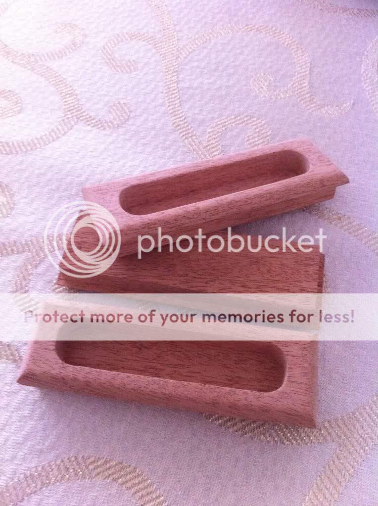

I have the above router and bushing set with a 1/4 spiral cut router bit. I would like to route out a depression to mount these drawer pulls (I made them). The base is rectangular and roughly 1 1/2" x 4 1/4 inches and is 1/4" deep. My plan is to make a template to route out the depression and practice on plywood before I attempt the Honduran mahogany drawer fronts.
Any advice?

Answered my own question by buying a 1/4" DOWNCUT spiral bit. It made a fine edge with no tearout on the top surface.

I was worried about ruining solid mahogany drawer faces. After a bit more time thinking the confidence allowed me to route out the mortises smoothly with a 1/4" spiral bit and a template. DONE
