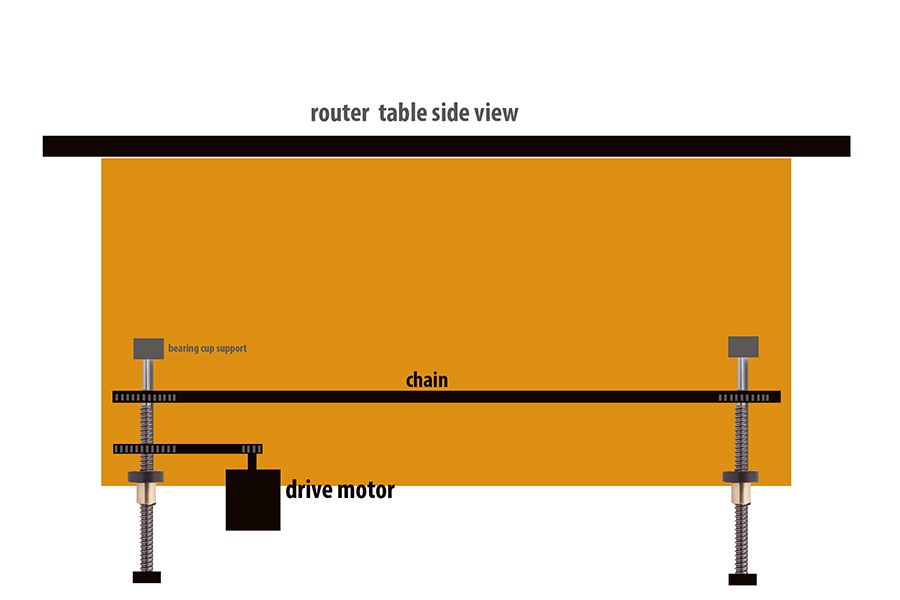

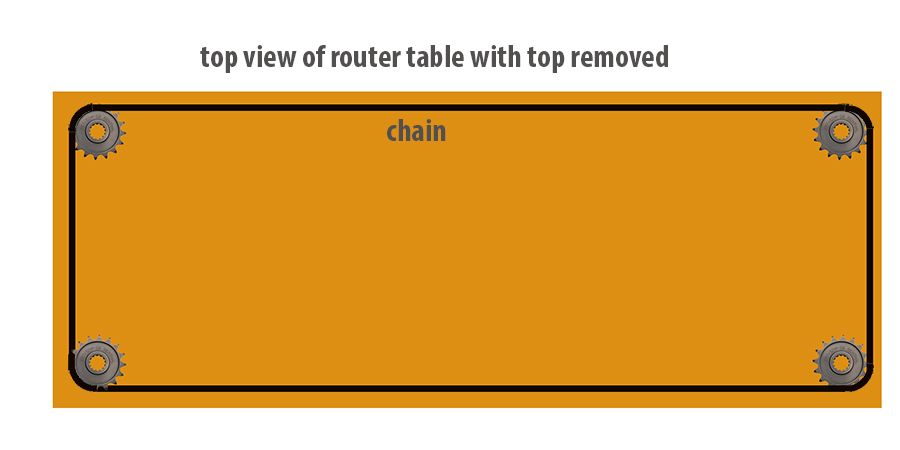

Gerry I have the exact same problem and I was going to build a router table that has adjustable height as I need just under 34" to make it work as an out feed table , but I think that's going to feel uncomfortable for routing .
But now I'm debating to build a 36" dual router table and instead build an adjustable height work bench / out feed table/ assembly table . It's sure going to get crowded in my garage though :(
This is example of an idea . I was going to kibosh the motor and use a cordless drill to change the height instead . I have bought 1" threaded rod and the sprockets already . Would have preferred acme linear rods though but there very expensive and tough to order here
