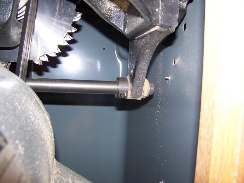

To get the blade to go lower, loosen the large nut on the end of the shaft pictured below, until the blade is at the desired height. Do this by putting a wrench on the nut & holding the handwheel. After the blade is at the desired height, you will need to readjust the stop collar on the other side of the casting. You will also need to loosen the set screw on the height adjusting handwheel & move it in after the adjustment.
Some of the older Unisaws had 2 stop collars instead of a nut. These are harder to adjust, but can adjusted.
