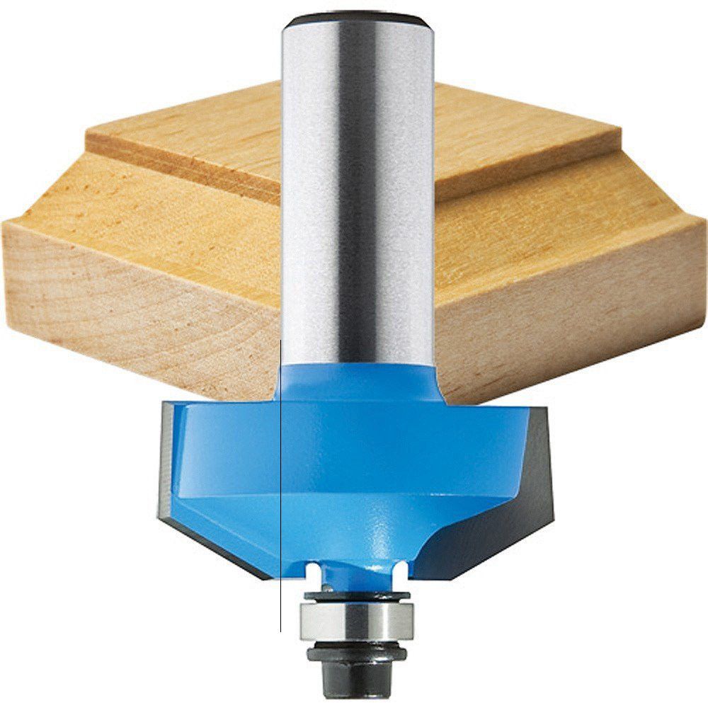

Hey guys, its been a long time since we last talked about this, but I need your help again. So last time I needed the blade part to be inverted and sticking out and above the router table, but now I need a bit that has a 60 degree edge with bearing that sits down into the router table and here is the hard part... I need it to be no more than 1 1/4" wide to fit into my table hole. I can't keep switching out the table insert so I just need to find this bit.
I found this bit here that would work perfectly, but the bearing doesn't extend all the way out to the blade since its made to have the top and bottom lip. I even thought about getting a wider bearing for this bit, but its more than the standard 1/2" bearing size.
Any suggestions? Shank size is not a major deal, but I would prefer 1/4", but will take a 1/2" to get this bit and save my fingers.
