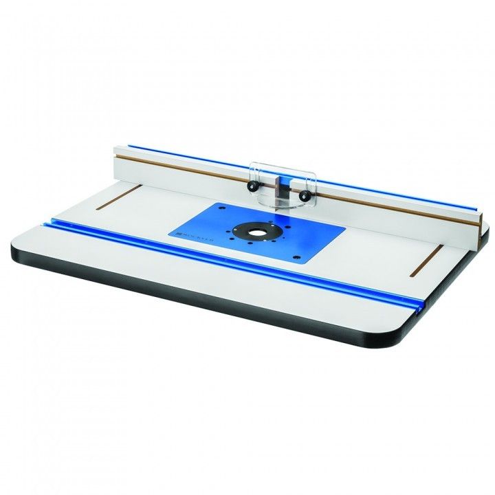

Mark, add an auxiliary table top to your router table. 1/2" MDF would be one choice for this. Make whatever size clearance hole you need for your bit and install the bit above your 1-3/16" opening in your table. (Provided your router has the reach and that your collet will fit through the standard PC opening)
If this wont work you could install a mounting plate with removable center rings like the $13 Grizzly T10432047.
Hey Mike, thats a possibility because I like how the insert in the pic has two rings opposed to my one ring. This is my exact table.
See how there is only the one black ring. If I had a setup like yours I could remove the inner 1-3/16" ring leaving a larger opening allowing my 60º larger chamfer bit to work well and not shred the plastic insert. The only problem is that I am still cutting small pieces and it MUST be perfectly flat especially when doing a bevel and since the hole is so big and the pieces are small this could cause slight bending of my template leaving uneven bevel cuts and gouges. You know?

Mark, Rockler has always sold blank inserts for their mounting plates. You drill the size opening you need.
