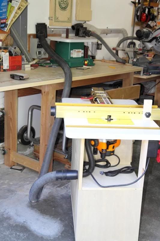

Because my 2 car garage doubles as my shop, space is definitely an issue if I wanted to park my vehicles in it. I purchase a shop vac and set it up under the counter of my compound miter saw. From the shop vac the hose goes to a 5 gal. bucket with a special lid that seperates the large particles from the small stuff. From the lid of the bucket, the hose connects to a 2" dust colletions system you can buy at the local big box stores. I have several ports that can be open and closed when I connect my hoses to them for the various tools. Works pretty well accept on the compound miter saw which tosses dust everywhere despite my best efforts to come up with something.
My router has a port that I attached a 1-5/8"hose to. It goes out the side of my router table cabinet where I can connect it to my 2" hose. My Incra fence also has a hose attachement so I can put the hose there as well.
