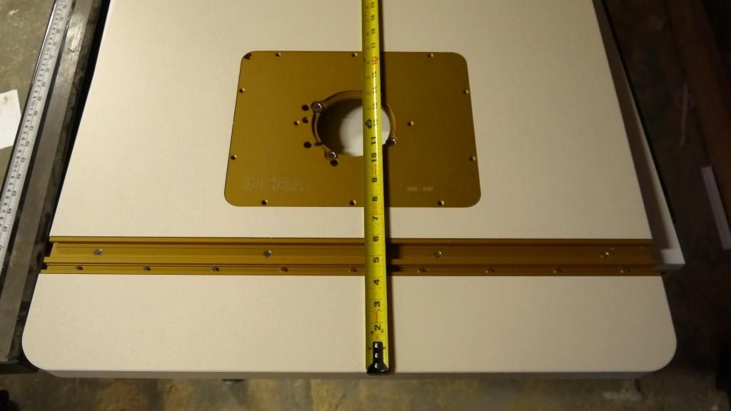

Stick I wanted to go with an Incra lift as I have there table and there clean sweep inserts . I think the same company makes both ?
I just checked my pc75182 and the collet was perfectly centred to it's chassis when I checked with my callipers . I would have to remove the back section in order to gain access to the rear of the rotor to check if it's centred but I hate to disassemble it for nothing other than piece of mind .
If the bearings become an issue and are replaceable I can live with that.
Stick , could that have been a bad run?

Just guessing here Joel but I think the offset would help by getting more material on the table to help line it up , hold it steady etc , on narrower tables that is .
I mean the most important part would be the cut at the bit , after that it's being out fed , so I guess after the cut it would be less critical .
I'm just learning myself
