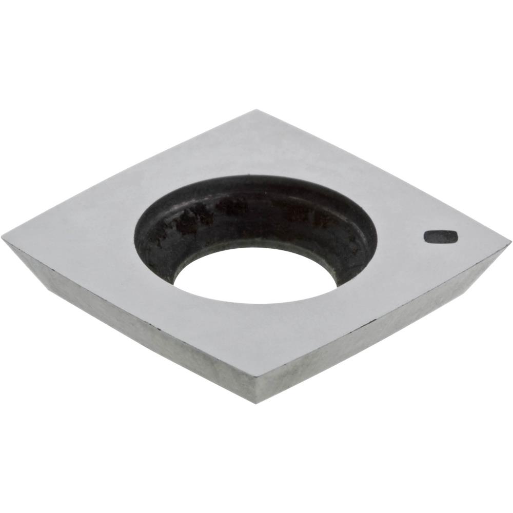

People here have told me that I will destroy MY helical planer by cutting these bench planks into boards and running them through. Something about the finish on the wood being detrimental to the blades, or it will clog up the machine, or ... ...
So my question is, can someone give me a way to STRIP the finish off of these boards economically, and with reasonable effort, so that the planks and other parts CAN be run through the planer without worrying about what the coating on the benches will do to the blades?

I was using a community hobby shop running painted boards through the thickness planer and the shop guy said to cut at least 1/16" below the paint, then the blades will be cutting mostly wood and not the hard enamel paint. If I were to do that again, I would do some test boards to see if that method is still accurate.
Is the coating on the wood really HARDER than the wood? I find it difficult to imagine that carbide blades would be defeated by a coating of lacquer or whatever it is they use to coat these benches. I do admit to having almost ZERO experience with woodworking, so I am not doubting you. I just thought that hardened steel blades would not be bothered by a layer of lacquer or paint.

I wouldn't worry about the planer cutters. Also, with that nice big sander, you have the perfect tool to remove all the finish. If you still want to strip it, use a water based stripper and clean it off with a good power washer.
It is a helical cutter. those little squares are 'Spensive, Lucy! :oops:
92 Inserts at $10.00 EACH!
I know those helical blades have FOUR cutting edges, so I GUESS I could go through a set, rotating them as needed, and then buying a whole new set after the fact ... I will cut a four foot plank and give it a test, to see how it comes out.
