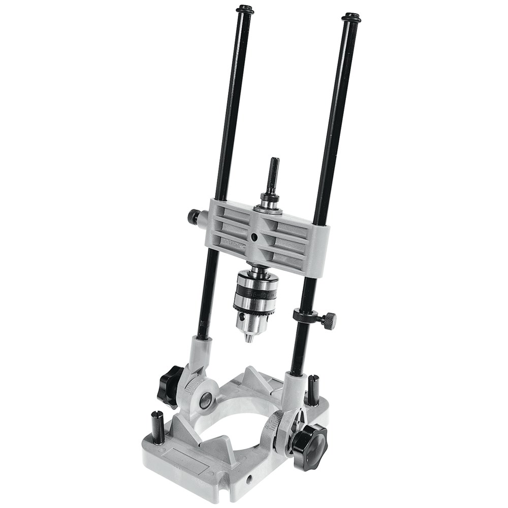

drill guide for the round holes...
do not cut the slots w/ the router w/o hogging out the material w/ a jigsaw 1st...
use the router w/ a trim bit to dress the slot's sides...
Actually, I had my heart set on the panel with the cutout slots.

By the way, who makes that drill guide?
