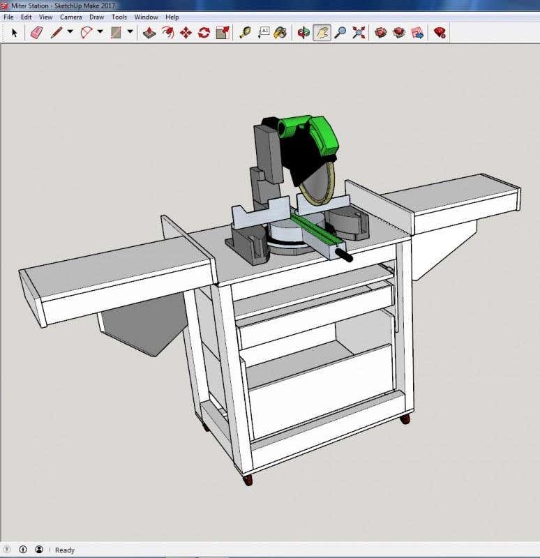

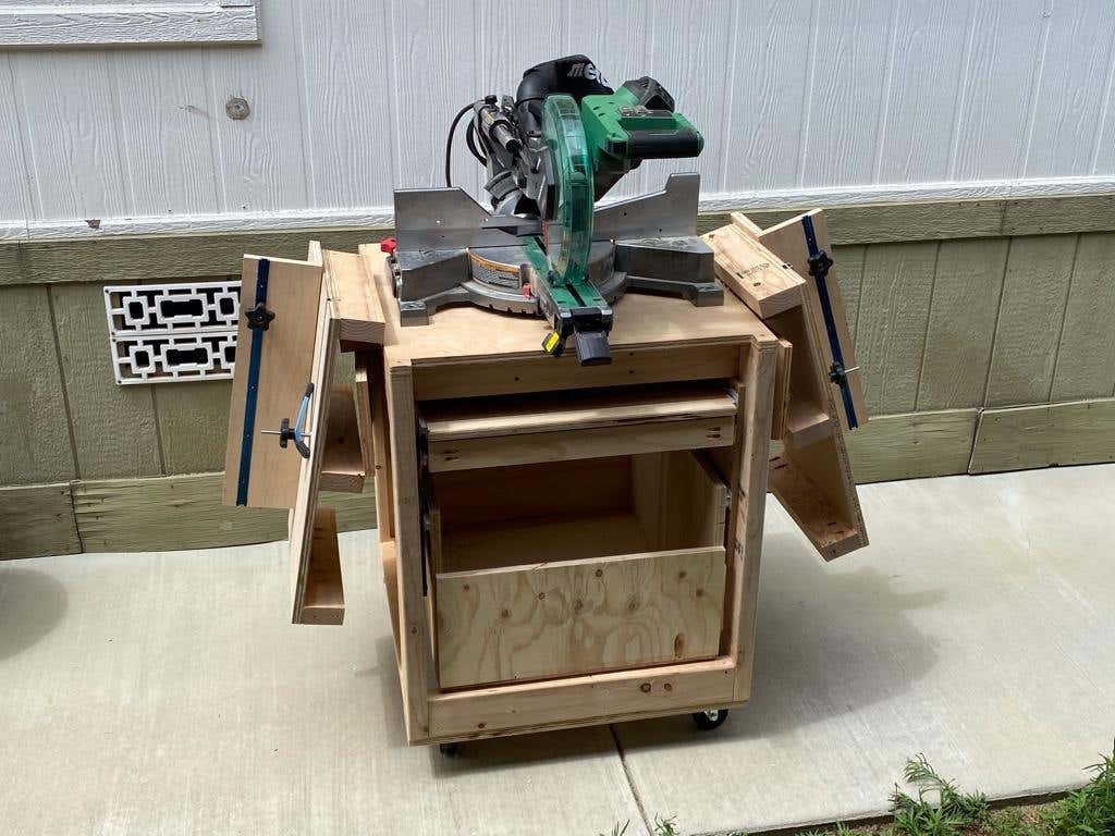

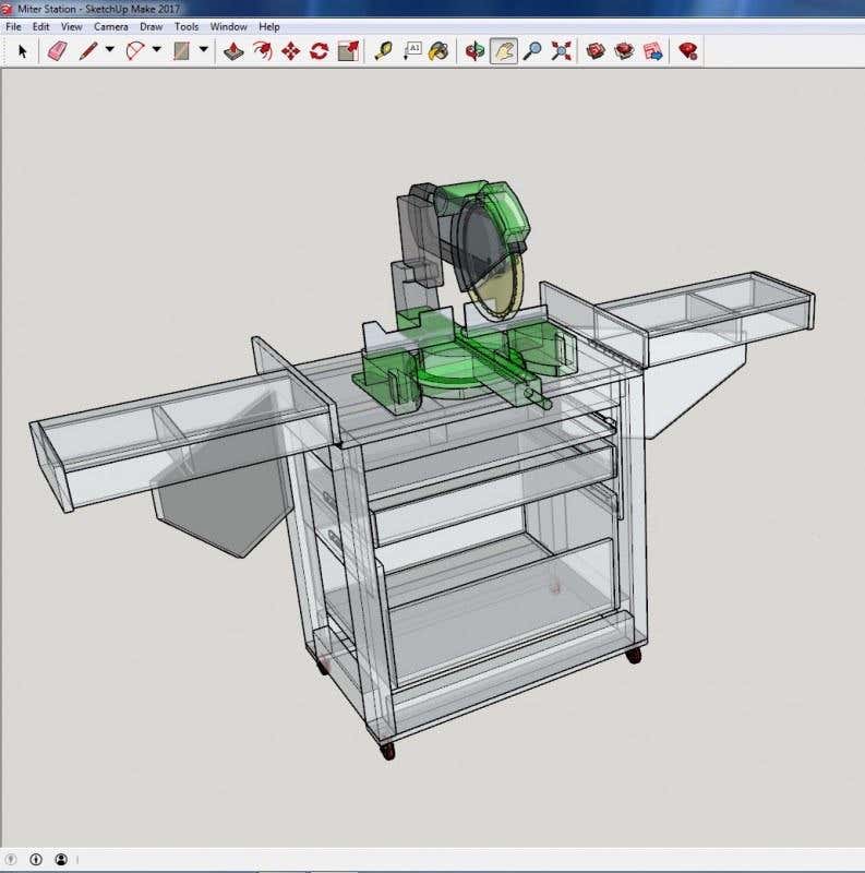

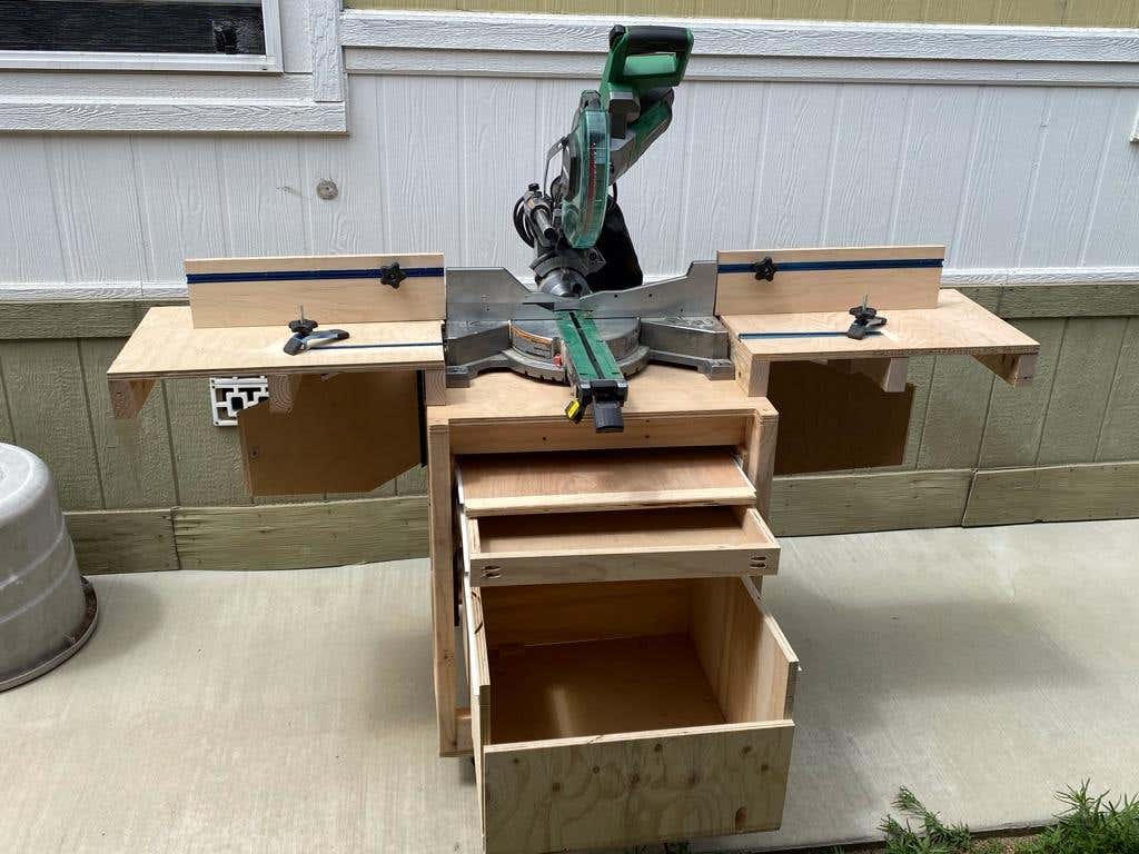

For those with space restrictions. Things have to be compact, functional & mobile. This one is a miter saw station I recently finished:
Highlights:
-Removable & adjustable fence
-Folding extensions and extension supports
-Casters
-Extension supports feature micro adjustment shoes
-Integrated t-tracks for all kinds of stuff
-Sliding blueprint tray, small stuff drawer & bin for cut offs
-Easy takedown with threaded inserts and knobs
Materials:
-2x4 dimensional lumber
-3/4” plywood
-1/2” MDF
Overall project cost: around $100 in materials (hardware is expensive).
Will share the SketchUp models, if anyone’s interested.
Sent from my iPad using Tapatalk
